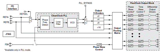

图1.ispClock 5400D方框图

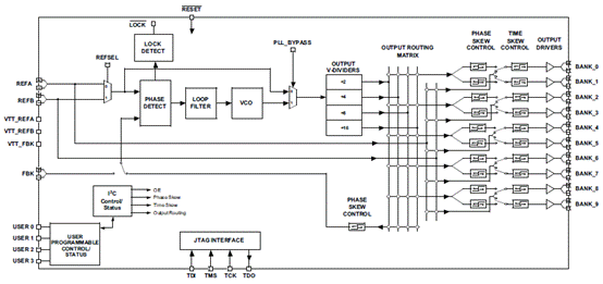

图2.ispClock5410D 功能方框图

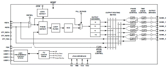

图3.ispClock5406D功能方框图

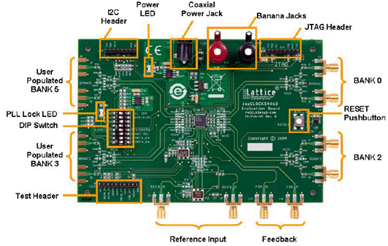

ispClock5400D评估板
This board features an ispClock5406D device that provides in-system-programmable zero delay universal fan-out buffers for use in clock distribution applications. The on-board ispClock5406D is a 6-output clock distribution IC. Differential ultra low skew outputs are organized with two banks per group. Each bank may be independently con-figured to support separate I/O standards (LVDS, LVPECL, HSTL, SSTL, HCSL, and MLVDS) and output fre-quency. In addition, each output provides independent programmable control of phase and time skew. All configuration information is stored on-chip in non-volatile E2CMOS? memory.
ispClock5400D评估板主要特性:
The ispClock5400D Evaluation Board package includes:
&bull; ispClock5400D Evaluation Board
&ndash; The board features the following on
-board components and circuits: ispClock5406D programmable clock (ispPAC-CLK5406D-01SN48I)
&ndash; Crystal oscillator circuits
&ndash; Can oscillator circuit landing
&ndash; Resistor networks
&ndash; SMA connectors
&ndash; Power jack
Test and JTAG interface headers
&bull; Pre-loaded Base Demo &ndash; The kit includes a pre-loaded demo design that highlights key performance character-istics of the ispClock5406D device.
&bull; Lattice ispDOWNLOAD&trade; Cable (HW-USBN-2A)&ndash; The ispDOWNLOAD cable provides a hardware connection for in-system programming of the ispClock5406D device.
&bull; User’s Guide &ndash; Provides information on powering, connecting lab equipment, and using the board as a clock source for various Lattice FPGA evaluation boards. The contents of this user’s guide include demo operation, top-level functional descriptions of the various portions of the evaluation board, descriptions of the on-board con-nectors, switches and a complete set of schematics.
&bull; QuickSTART Guide &ndash; Provides information on connecting the evaluation board, running the pre-loaded evalua-tion demo.
图4.ispClock5400D评估板外形图
