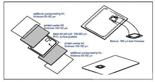

图题:双接口非接触式智能卡的典型构造
additional overlay-coating foil, thickness 50-100um:附加覆盖层,厚度50-100微米
printed overlay foil, thickness 100-150um:印刷覆盖层,厚度100-150微米
basic foil with coil: 200-300um, PVC, surface glueless:带线圈的基层:200-300微米,PVC材质,脱胶表面
Module: 540um total thickness:模块:总厚度540微米
